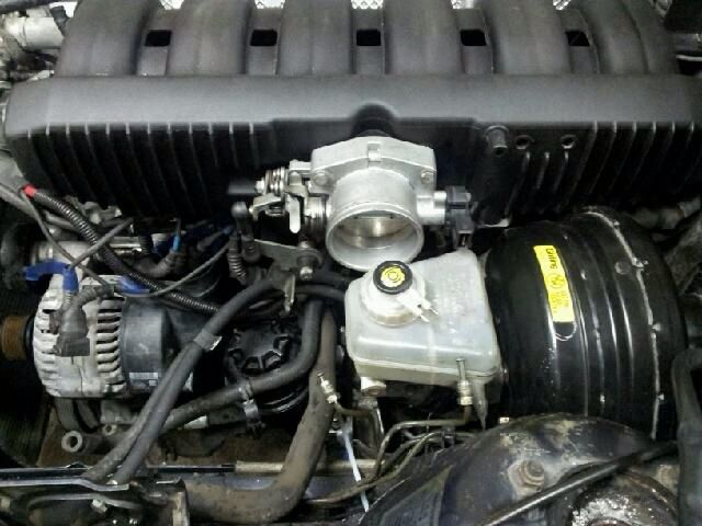

    Hey guys,
    Once again looking for advice/input. The end is in sight.
    It seems like the e32 booster sits very far forward. Does this look normal? Do I need to some this by using a remote reservoir?
    Clearly the current set up will not work.
    Thanks in advance!

    Remote res or remove spacer.

      ^this. Just get an M10x1.5 die and thread the push rod further, almost to the end of it. Shorten it. Use the spacer to mark the two holes you'll need to redrill in the fire wall and everything will line up nicely, with lots of space. You can find the die at your local auto parts store today and have it all done before the days over instead of trying to source parts for a remote reservoir. Good luck.

        Thanks for the replies guys. Lookig like I'm going to grab a wilwood remote reservoir.

          Pretty pricey when all you need is one for a 76 2002tii...

            If you haven't already, you can remove the booster spacer that connects it to the firewall which will being it in another inch or two. 2002 reservoir is the way to go but you'll need to build a bracket to mount to the strut tower or firewall.
