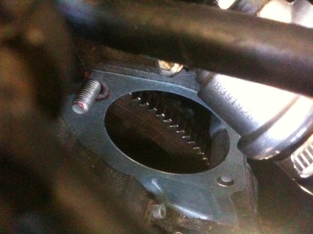

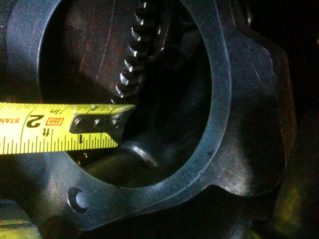

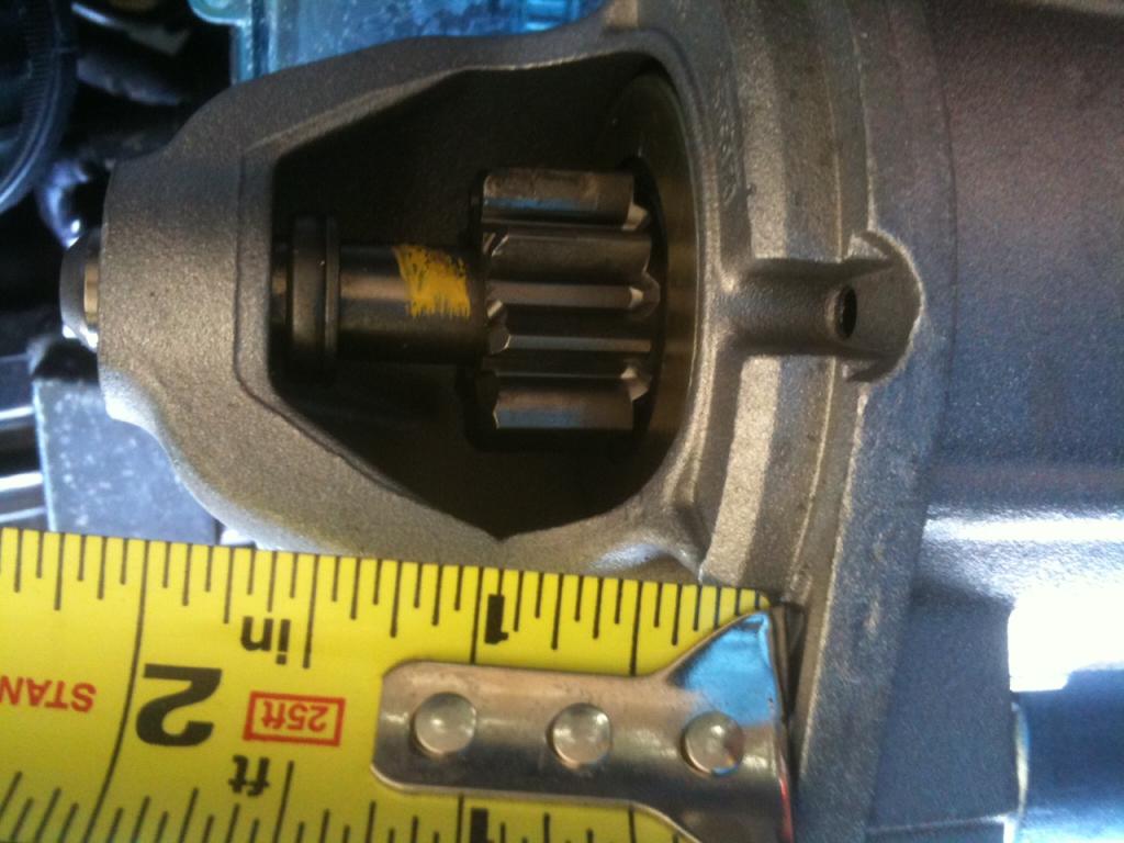

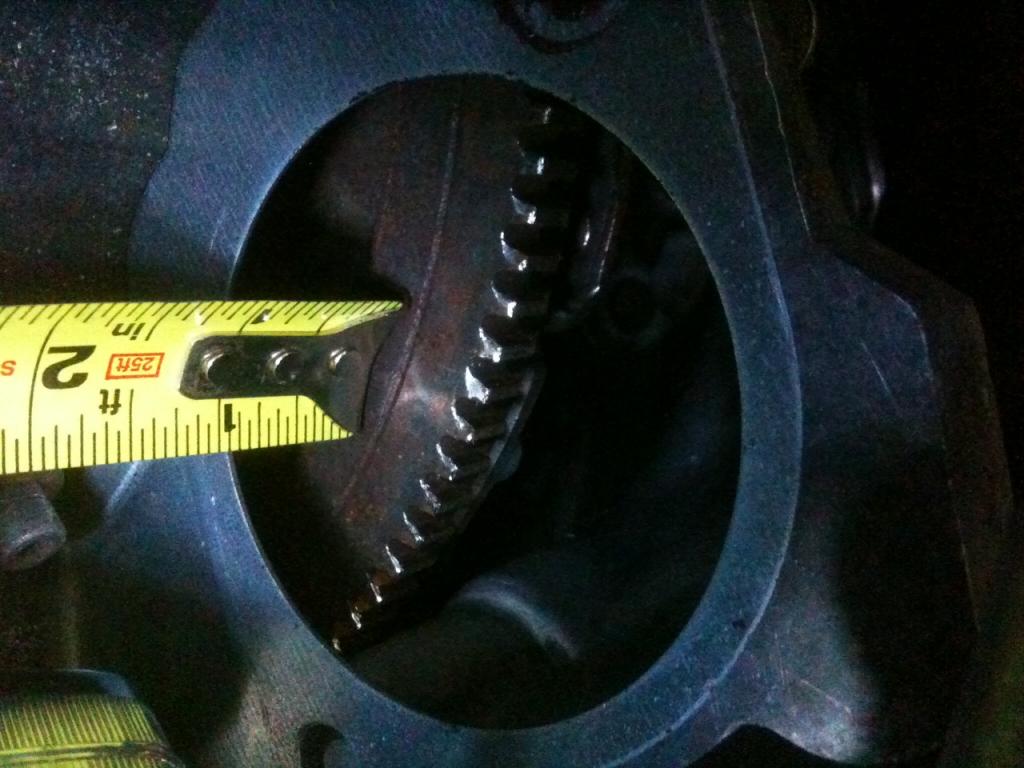

I measured distances from mounting points of starter to flywheel front and back, see pics. Also measured the starter opening with gear. It seems that they are where they should be? Also measured voltages at starter - big post reads 12.8V, and middle size post with black/yellow wire reads 12.6V when I turn the ignition key. Smallest post has black/green wire attached, which I understand is the unloader wire, didn't measure voltage there.
