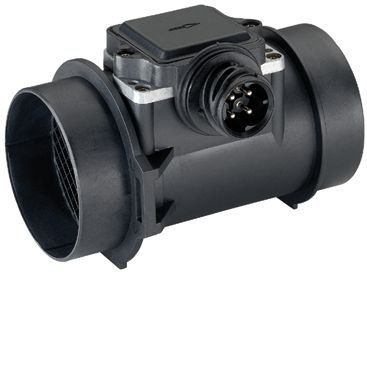

      Here is the style MAF i need to fit my harness. Its the Bosch MAF. Did they make that for OBD1 and 2?

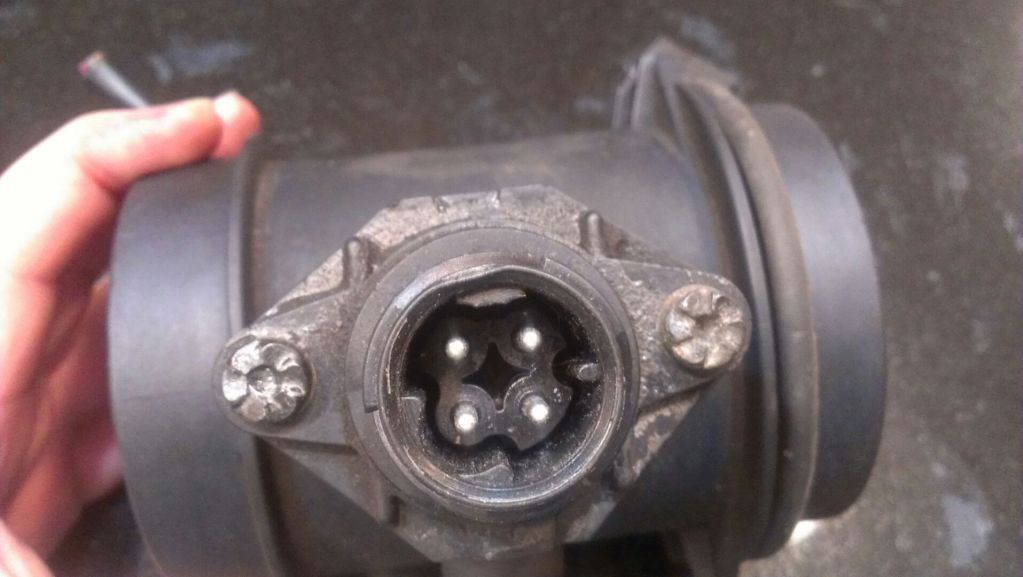

        This is the MAF that i currently have and doesn't plug into my harness which my harness is supposed to be OBD2.

          Thats an OBDII maf, so you must have an OBD1 harness if it doesn't plug in. The plug wouldn't vary from manufacturer.
          Easy way to check is look at your coil pack harness.
          OBDII
          OBD1
          1987 325is - S52
          • duval7
            • 77
            Mine is the OBD2 coil pack harness for sure. The plugs do differ for Bosch and Siemens. You can see in the pics above the gates that allow the plugs to set are different. Thanks for the input tho. I am beginning to think the both manufactures made both OBD 1 and 2 MAFs. When and why two different MAFs were used is puzzling.
