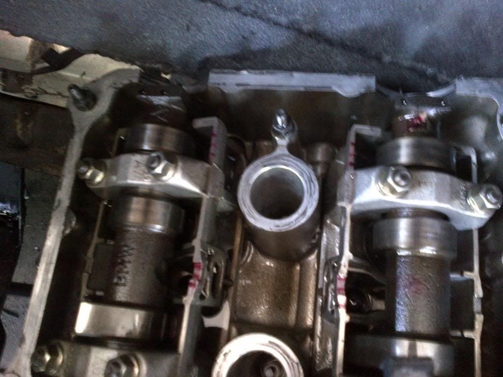

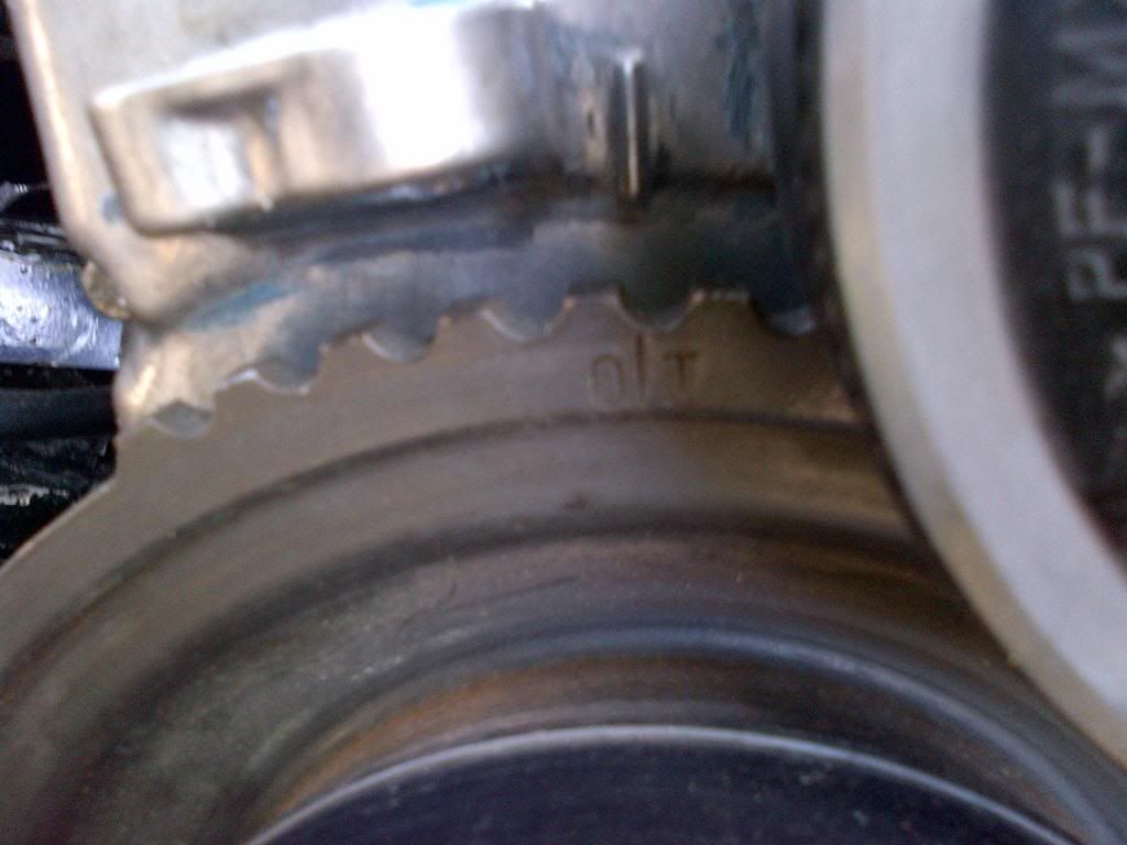

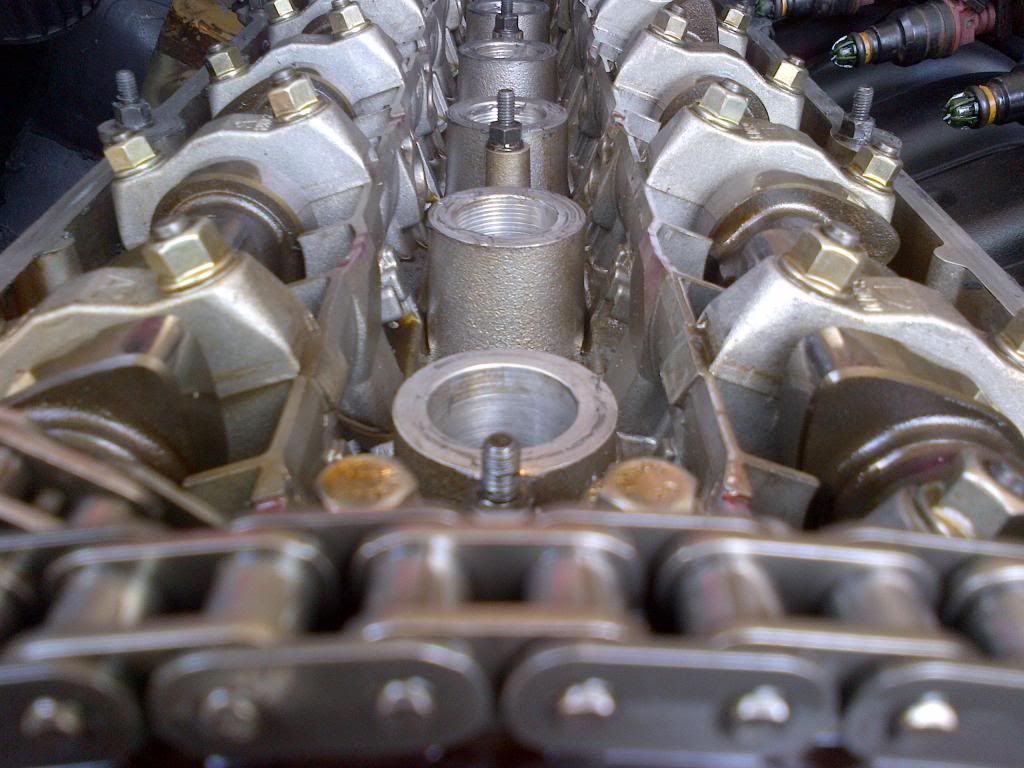

    It cant be my timing i triple checked that shit. i changed the icv, checked the ground straps and grounds for coils. resistance on all coil seem great. is there a ground im missing for the coils? i got a ground strap on cyc 1 and 6 and the middle has the injector ground i believe.

                        i checked the timing just in case but its timed correctly. hmmm
