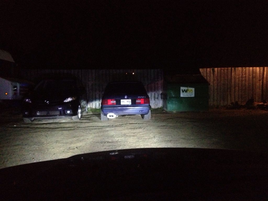

                  • nl328i
                    • 556
                    This was the best my mechanic could get the e36 exhaust to fit (using s50 to the cat, then an e36 Borla from the cat back.) It works, but as you can see if hangs a little low and to the passenger side. At some point I'll probably switch to something different, but for the time being I just want to get this project rolling!
