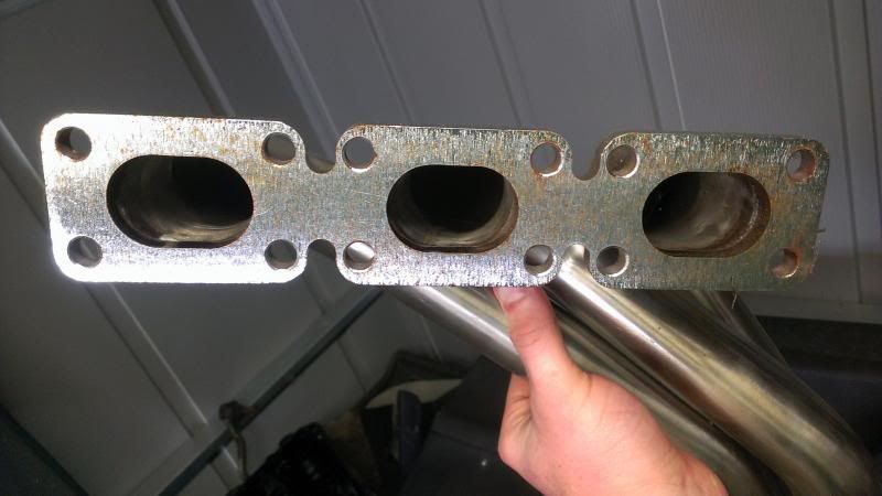

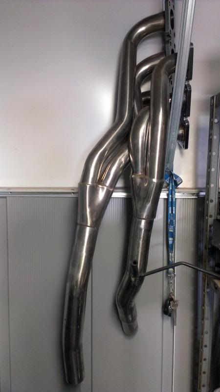

    Any idea if these will fit without too much problem? I'm trying to replace my 2-piece racelands with something that won't need as much work. Thanks!

    i have them on my e30 using 2 e28 535i green mounts
      Sounds good, thanks!

        Are those the Supersprint replicas? I have them on my car with E28 535 mounts. They fit pretty damn good, and you can't beat the price.

          I don't know, the seller just said "ebay headers"

            I have them on my S52 swap with the AKG swap mounts. The mounts are way lower profile then the E28 mounts but bring the weight of the engine lower in the car which is cool. (As long as you have a skid plate!) The passenger side mount has a few spacers to lift it up a little to get the headers to fit, and the firewall did have to get hammered in a tiny bit but they do fit!

              I have them too, but mine fit like ass. Using e28 green engine mounts, the front header was mashed against the subframe and the rear jammed into the underside of the car. I made it work, but it wasn't fun. Maybe I just got a set that were a little off.
