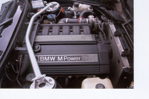

                Here's my engine bay:
                  Nice. What supercharger is that? Any fitment issues?

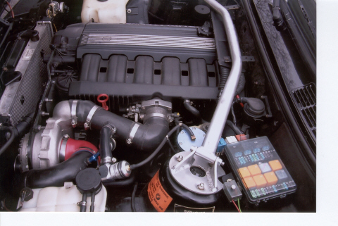

                    #54
                    And another:
                      Thanks. I'm running a Powerdyne BD-11A Supercharger. The only fitment issues occured between the front of the blower at the top & the rad hose. The 2 rub together, so I added another layer of heater hose to avoid any potential disasters. However: I'm running an e36 rad. This wouldn't be an issue with the e30 2.5L m20 rad which doesn't stretch as far across the support.

                        #56
                        Mr M tech do you have any dyno charts for your car?
                          Also thanks for the P/Ns for the M3 covers. I'll get right on that.
                          Good to know, that thing must haul balls. Seconded for a dyno chart.

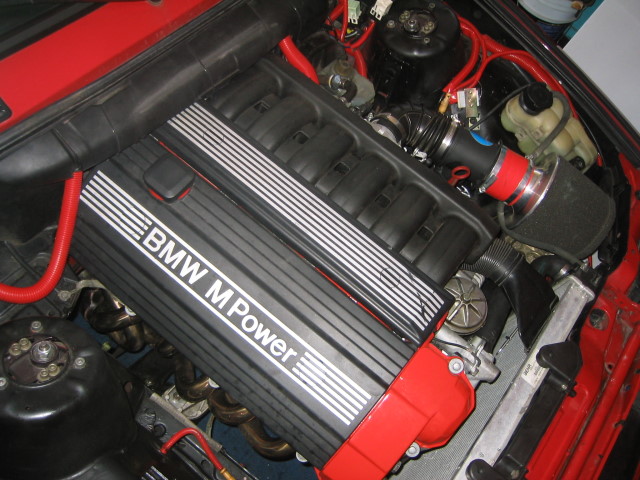

                              #59
                              heres a couple of mine

                                #60
                                WOW, that is a clean engine bay.
                                What are you usin to clean up all the wires on teh firewall?
