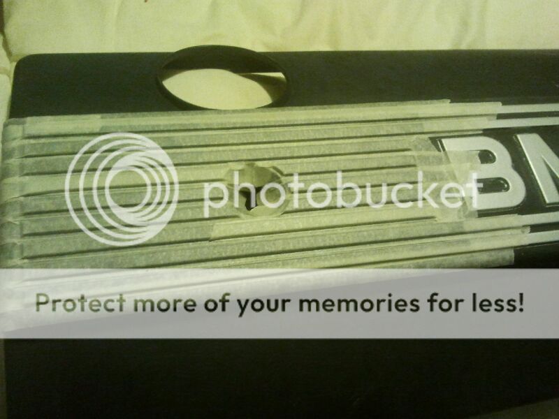

    First up was the engine covers as it is easiest, or so I thought. I only had normal masking tape and my spraypaint. So the masking started, and believe me it took FOREVER!!
    Then the freaking stripes!!
    I then found some overpriced tamiya tape perfect for the job and the fuelrail cover was done in a jiffy!
    So ya, not bad. The cover has an oopsie so I supose it was just a trial. When im flush again ill get a perfect one.

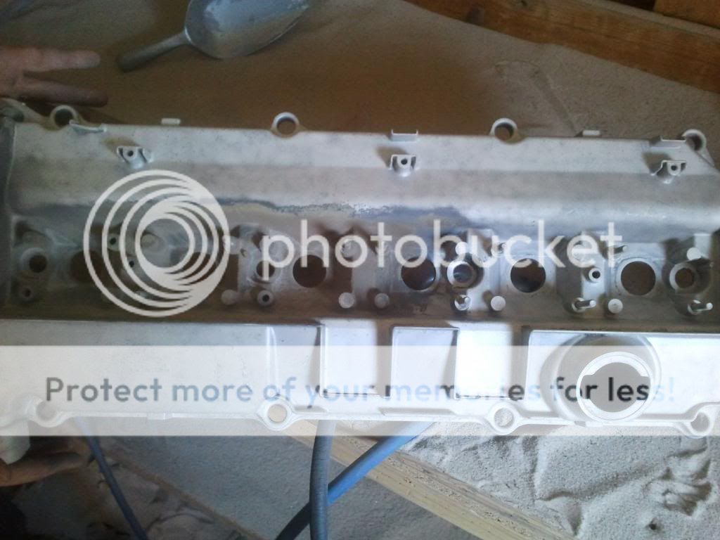

    After that I tackled the tappet cover. Tried paintstripper but did nothing. Then I left it over night and that just made it worse... So off the the sandblaster.

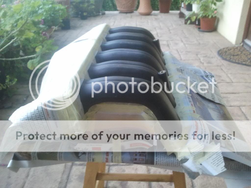

    So I started working on the intake mani...
    The spraying didnt really go as planned. The previous owners must have put silicone on or something, because even after a lot of thinners it was still running no matter how light I sprayed. Any whoo it came out decent, will touch it up once installed and I see what looks crap and what doesn’t.
