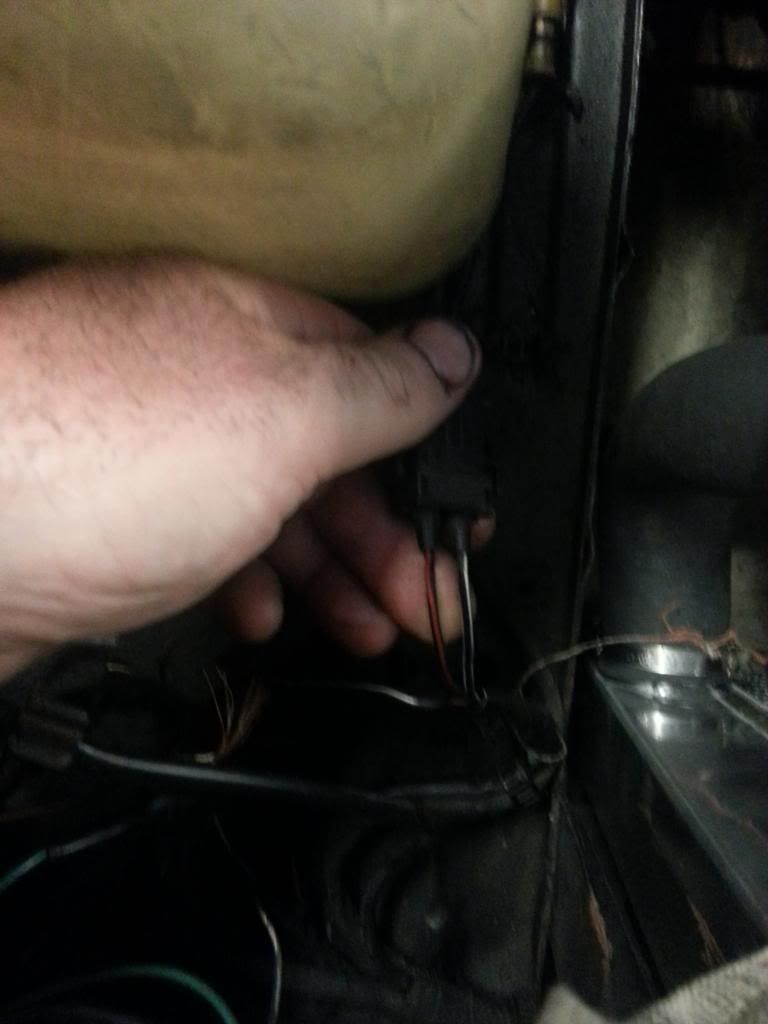

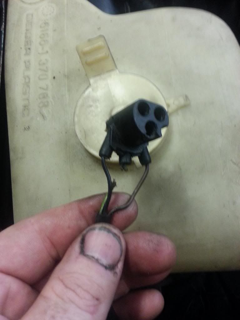

    The previous owner did the swap and completely removed ALL A/C parts and some of the wiring isn't the best and I completely suck with wiring so I took some pics of the possible wiring connectors I have remaining.Yes I've read all the fan wiring threads but need some help still,sorry in advance for my lack of electrical ability.:oops:
