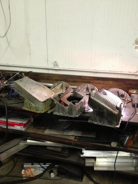

    this could be an option. check out the r3v facebook page and message David Curci.
    • meengreene30
      • Mar 2012
      • 369
      Trying to gauge interest on these. We are currently working on an m20 clearance pan as well. This pan will gain you about an inch of clearance while retaining the factory capacity. Anyone interested in bottoming out on your rack/subframe instead of the oil pan?

            Im interested
