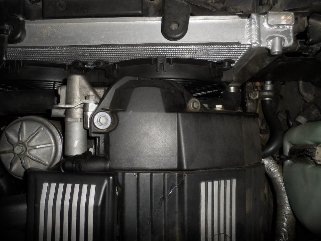

    Hey guys. Just finishing up an M50 swap, and i'm looking for a fan setup. I have an E36 mishimoto radiator, and i'm wondering if anybody has experience with putting a fan in-between the engine block and radiator. Has anybody found a fan that fits? And if you do have one that fits, could you give me a part number? I know SPAL makes one that is supposed to fit. Thank you!

      I used 2 of these http://www.ebay.com/itm/2-X-UNIVERSA...-/190605560351 I got them from DNA motoring for about $40 along with a CX Racing e36 Aluminum Radiator http://www.ebay.com/itm/CXRacing-Alu...7beafa&vxp=mtr it just fits but it works well through 2 summers now

          low profile 16" spal might fit. It would be very close though. Any reason why you want it between the block and rad? With the mishimoto radiator and front mounted fan these things stay very cool. I even have A/C condensor and front mount fan and it never overheats or even gets to the half-way point.
            The low profile Spal 16" puller is a tight fit with my CX Racing. We took a few mm off my WP pulley shaft during the swap, and I ended up moving the fan to a more off-center position soon after because it was still making slight contact when driving the car hard.
            On his swapped car, bimmerteck has a Spal pusher in front of his Mishimoto and it seems to work fine.

              Yes it just fits w/ the fans set up as pullers

                        Perfect guys. Thanks for the help. Went with the 16" SPAL fan. And it is a very close fit. If anybody wants the part number, I can post it.

                            Puller is 30100400
                            Pusher is 30100401
