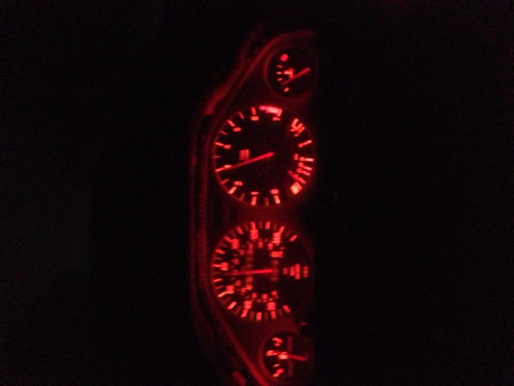

                    Get a mishimoto radiator with a Spal 16" slim pusher fan, along with the low temp thermostat. This is what I have and my car runs about 135-145 degrees.
                    This is after about 50 miles

                      I have a Mishimoto radiator, and its leaking. A 16 inch puller wouldn't fit.
                      Also a car running that cool isn't really optimal.

                        That is too cool in my opinion, also
