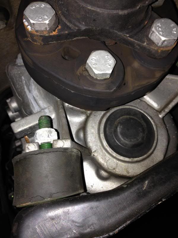

    I inspected my giubo today :
    On screen it might be tough to tell but, the arrow indicates my installation is wrong. Reading the instruction on how it should be, I knew that I hadn't noticed or heard how do it right when initially doing the swap.
    I haven't done too many miles with it like this and the rubber shows no signs of deterioration, only flash from manufacturing. I was expecting worse. Maybe I'll notice more when I adjust it. I'm wondering if the flex disc might have just softened enough over time to reach a point where it allows resonance despite not being cracked.
    I'm sure it won't last as long but I'll clock it correctly and give it a whirl, and report back. I'm hoping that I won't need to replace my driveshaft, maybe I killed the CSB? Maybe the centering sleeve is the issue? How can I tell if the u-joints are bad?
    Also - is that left side trans mount busted? I might have to get the UUC cups..

    Its in backwards. Looking at the pic the driveshaft turns counter clockwise. The output flange should push the thick rubber while spinning forward. The way you have it is literally tearing it apart..
    Yea those mounts are dry rotted. Get some 'thane

      I realize now that it's not oriented correctly.
      I suppose I'll find out when I correct it, but I'm wondering if this wrong orientation could cause a vibration.
      I'd also like to check the driveshaft while I'm in there, but I don't know what to look for or how to tell that the driveshaft is ok or that it's bad.
      I heard urethane trans mounts are very iffy as far as the NVH, and I don't want to chance it. I suppose I should replace the E21 rubber mounts and put cups on them. But, I really need to sort out the driveline first.

        If you re read my post i was explaining how the wrong orientation destroyed it.. Get a new one, put it in right and youre good to go.
