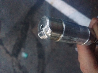

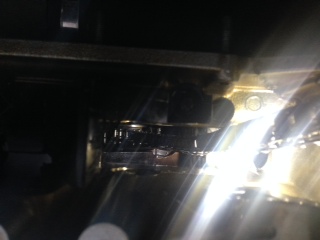

    Hello everyone. So I was in the process of rebuilding my vanos system and found an awesome present for my engine. I have no timing chain guides what so ever. I mean they are just gone. So I have to pull my timing cover to replace everything. I have heard that i have to pull my head. Is this really true? Or can I do everything with my head still on.
    as you can tell in this picture they are gone and the bottom one is chipped.
    This also happened.

    How did this engine sound normal running?
    I dont think you have to pull the head to pull the front cover but I did, there was other stuff I need to do at the same time.
