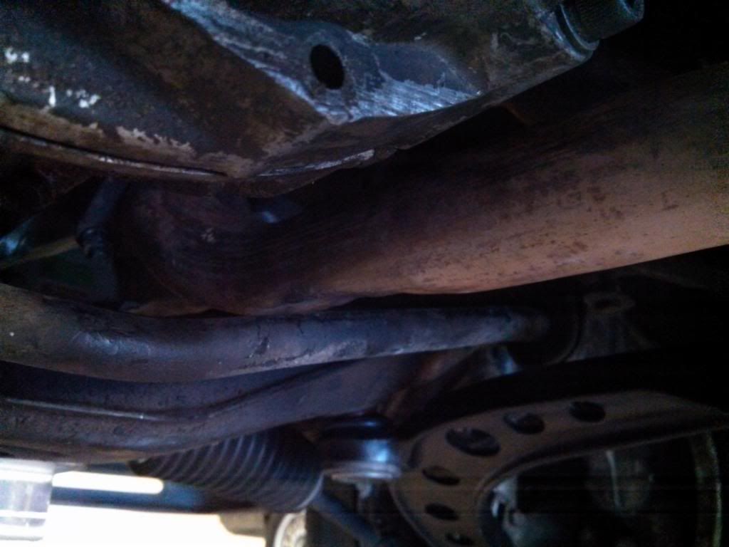

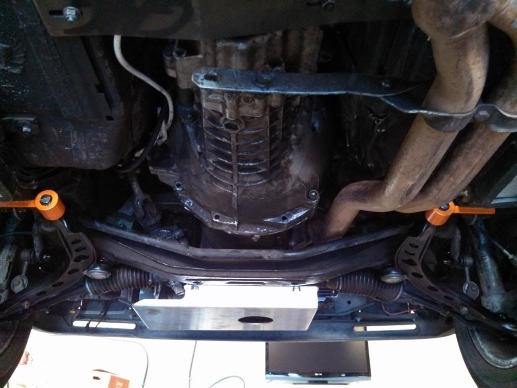

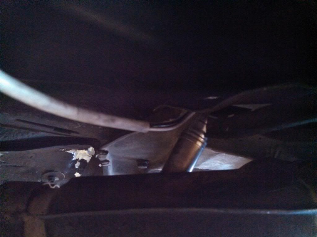

                      Had the car up on a lift today so I snapped some pics of the exhaust for you guys.
                      Correction to my original post, the mid section is from an M50/OBDI E36. Rear section is an ebay part for E36. Needs treehouse/bimmerworld/top speed control arm eyeballs and the downpipe needs to be "massaged" to clear the sway bar. Also the cross member needs to be notched for the O2 sensor to fit.

                        Can you repost the images their links are broken
                        • ParsedOut
                          • Sep 2005
                          • 1437
                          Fixed, sorry I reorganized my photobucket last week.
