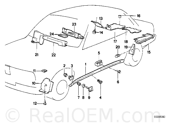

    E30 M3 Harness Cover
    Does anyone knows what's the parts number or the name for this part? I think they only come in E30 M3, I'm not sure.
    Thanks in advance.
  • rs4pro3
    • 5808
    The middle cover on the firewall is 51711380391
    I'm still trying to find the part numbers for that far left and the other panels
      Thank you very much!
      Here's the number for the far left: 51711380392

        The middle piece which contains the relays and the c101 plug is also common to the 318is... qimis I have one if you want to pick it up.
        Its actually two pieces a mounting piece and cover that snaps into position.
        The far left piece which covers the battery junction block is specific to the M3

          I thought the passenger side trim piece (M3 specific) was no longer available, but it comes on up Realoem.com. About $40 for both pieces
                    i got mine from BMA
                            RealOEM is just a dump of the ETK so you can't go by it to see if stuff is available or the if the prices are accurate.
                              I take printouts from the site to the dealership when I order parts, and the prices are actually pretty close.
