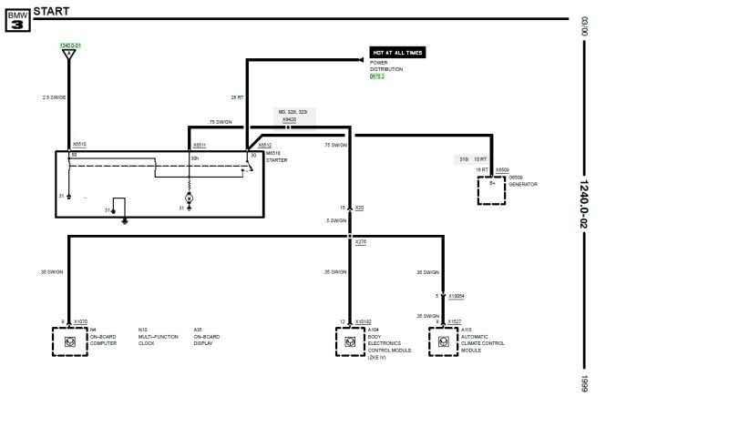

            Lets clear this up.
            Terminal 50 is heat from the key. That pulls in the 12v contact for terminal 30 which is your two main wires and runs the starter motor.
            Terminal 30h grounds out when it sees 12v from terminal 50 basically unloading those accessories by giving those relays a path to ground.
              #36
              Covering several things mentioned...
              Pin 7 of C101 goes to the Hot in Run and Start circuit which also goes to one side of the unloader relay coils. Pin 15 goes to the other side of the unloader relay coils. So with the ignition on (and the battery disconnected) there should be connectivity between pin 7 and 15 on the body side of C101.
              Pin 18 of C101 is the Hot When Starting circuit and has to go to the starter's solenoid control lug (black wire with yellow stripe). Pin 7 is the unloader circuit and goes to the unloader switch in the starter. That switch is closed when the solenoid isn't energized and grounds the unloader relay coils, causing the relays to close. On an E30 starter the solenoid and unloader lugs are different sizes and I think that is also true for the E36 starter. Which means that one of the wires will only go on one of the lugs. So if you match up the wire lug with the correct sized starter lug the starter is correctly connected.
              In case there is any doubt a test light will tell you which wire is which. With the wires disconnected from the starter the unloader wire should have power when the ignition is on and when the key is turned to start. The solenoid wire will only have power when the key is turned to start. With that wire connected to the starter solenoid lug if you hear the solenoid click when the key is turned to start, but the starter doesn't run, the starter isn't grounded, there is a high resistance in the stater's power connection, or the starter is bad. The starter is grounded by the block, so the engine to frame ground strap must be in good condition and making good connections. High resistance in the starter power circuit will be a bad connection somewhere.
