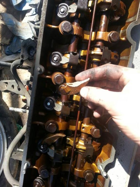

    feeler s50 or m20 stroker?
ID:	7238598 so I replaced my engine in my 325is and now that I have time I was tearing down the old engine, which I thought would be time consuming and pricey to fix. (no compression) then I found this. I was originally going to rebuild my s50 that came out of my m3 when I swapped a 2jz in it, but now im thinking of a stroker. opinions, advantages and disadvantages to both the s50 vs the stroker would be appreciated.
    Sent from my SAMSUNG-SGH-I317 using Tapatalk
