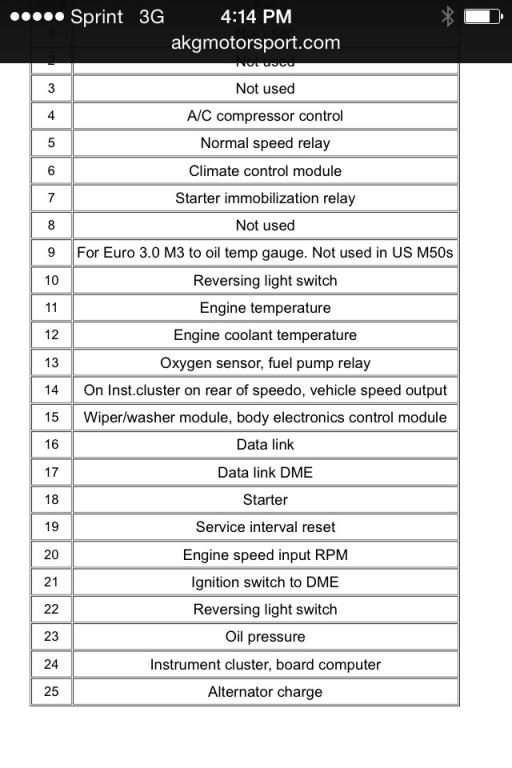

          Can someone please specify which pinnouts I need to have the motor running? I have the obvious ones but is their anything specific I'm missing? And also I'm putting the e36 cluster in my e30, but nothing is hooked up to the cluster at the moment...will that make the engine not run? The reason why I ask that is because does the dme need a signal from the cluster to power the motor up?

            Pin7 on c101 (21 x20) is technically the only wire you need
            To tell the ecu it's time to run, other than the power/ground wires

              Ok I figured out the buzzing noise, I replaced my dme, now I'm not getting fuel or spark, on pin 7...does that big green wire need to see a ground? Or positive?
              • e30rapidic
                • 2167
                large wire from pin 7 hooks to pin 21 on the M50

                  I have no wiring in my e30 as I said earlier so I'm not using the e30 connector, I have the full e36 connector in my car and I need to power this bitch up, I'm not getting fuel or spark, I'm going to check my crank positioning sensor right now

                    Pin 7 on the X20? That is EWS. Leave it disconnected/floating. Remove that wire/pin if needed.

                      Pin 7 on c101.
                      Pin 7 on x20 is infact ews,

                        yea right now pin 7 is just hanging there

                            Hey guys, I've got almost same problem ... in my M50B25 NV swap i have no ground signal to my fuel relay ... when i switch it on by grounding my fp relay (brown/green wire) it goes .. but when I tried to crank it my injectors are not opening and i haven't got spark ... so i checked all grounds, realays, fuses and everything is fine. Can someone please check my X20 to C101 plug connection -
                            1(Blue/white) - 2(Green/yellow)
                            2(Blue/yellow) - 10(Blue)
                            3(Red/white) - 20(Red/yellow)
                            4(Black/Blue) - non connected
                            5(Black/white/yellow) - non connected
                            6(Green/violet) - non conected
                            7(Black/violet) - non conected (it leads to pin 81 in dme connector x6000 ... what is it ? )
                            8(Grey) - 12(Grey)
                            9(Green/blue) - non connected (goes to pin 60 in dme)
                            10(Brown/black) - non connected (goes to pin 65 in dme)
                            11(Brown) - non connected
                            12(Brown/violet) - 4(Brown/violet)
                            13(Green/violet) - 13(Green/violet)
                            14(Brown/red) - 14(Black/white)
                            15(Black/green) - 15(Black/green)
                            16(White/yellow) - non connected
                            17(White/violet) - 16(White/black)
                            18(Black/yellow) - 18(Black/yellow)
                            19(White/green) - 11(White/green)
                            20(Black) - 9(Black)
                            21(Green) - 7(Green) - there was 2 wires - one smaller and one bigger, I soldered them together
                            22(Green/white) - 6(Green/white)
                            23(Brown/green) - 5(Brown/green)
                            24(White/black) - 8(White/black)
                            25(Black) - 1(Black)
                            I also checked my crank sensor via dme pin 16 and 43 and i've got 520ohms
                            On my pin 26 there is 12V+ like on pin 54 and 56
                            And i've got ground on pins 55, 6 and 34
                            My main relay is just working fine.
                            And something about my setup .. Euro E30 sedan M20B20 7/1990 with OBC (couldn't it be code function ?) ... engine M50B25 NV 1991 came off E34 touring, dme 402.
                            I hope someone help me :)
                            Thank you guys and sorry for my english :(
