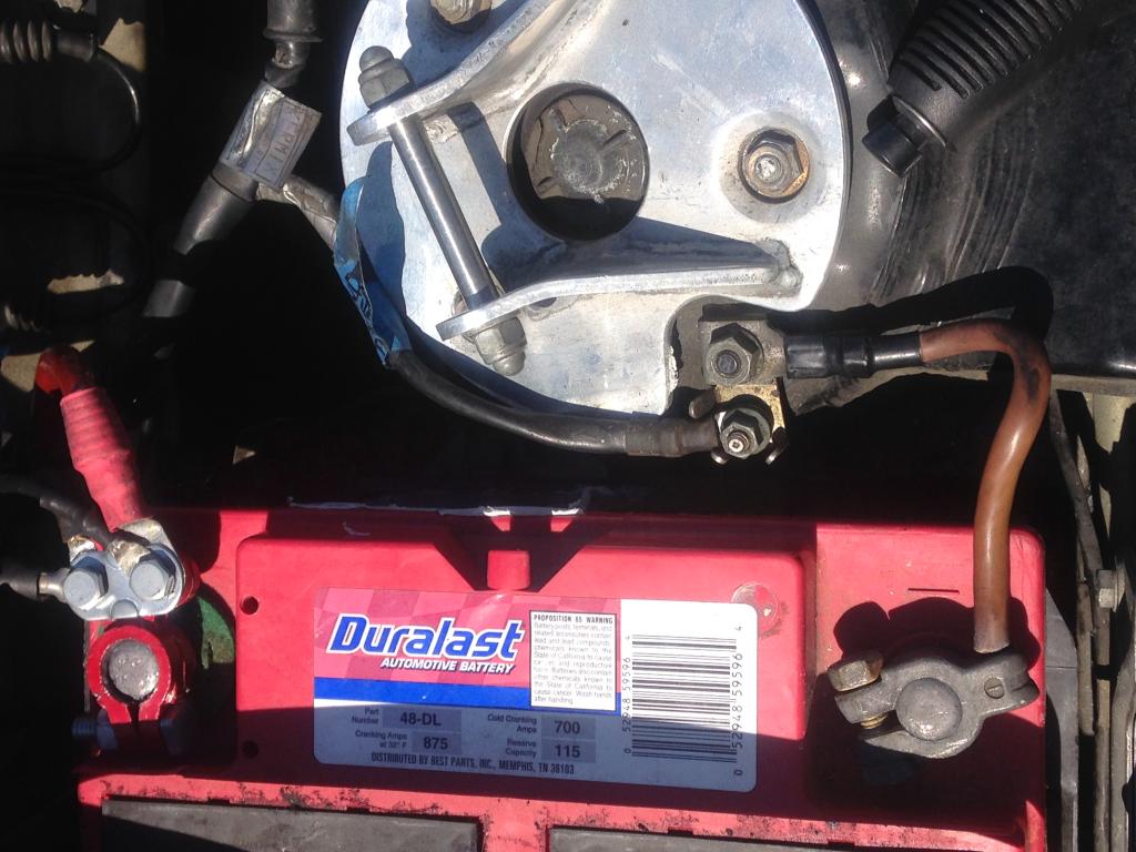

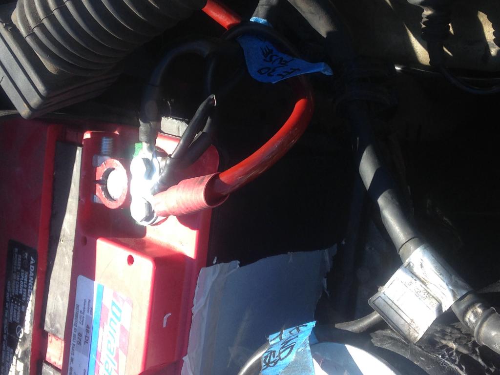

    All your grounds and power leads hooked up properly? Post some pics of your battery junction box.

      Here's the pictures like you asked for. There's no power distribution block since this is a convertible, so all the power wires go to the positive side of the battery (that's how it was on the m20). The two smaller wires are from the fusebox.
      For the ground side, there's the battery ground itself, as well as the ground from the harness itself. I know this doesn't look too pretty, but this is what I have to work with. Perhaps I wired this up wrong. I checked the frame rail ground and it's good, as well as the ground going to the front engine hook.
      Sorry for the bad cell phone pics!
