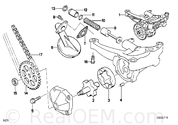

                  Which of these parts do I need?
                  Just 6, 7, and 8?
                  Is it the bracketry on the pump you guys are talking about modifying?
                    Just 6, 7, and 8?
                    Yes, you just need 6, 7, & 8.
                    It is the oil tray thing on the e34 oilpan that needs to be grinded a little. Also, one other bracket that holds the e36 oil pickup needs to be removed.
