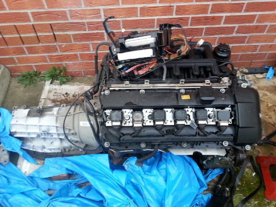

single or dual vanos
  • pisana
    • Sep 2014
    • 17
    Purchased from a e39 and the year is unknown.
  • mpowerful
    • Jul 2013
    • 1273
    Dual
    • tytypetersen
      • Mar 2012
      • 347
      The front of the valve cover will show it. One lump=single, straight across= dual
      • Liquidity
        • May 2014
        • 395
        That's a dual. The dead giveaway from this view is the modern idle-air control circuit. See the odd 6-fingered air-injection system running across the top of the intake runners? That was part of the technical update, not just the dual-vanos.
        • amcink
          • 788
          m54
          • Poorboyz
            • May 2012
            • 2117
            There should be an engine code on the drivers side block at the bottom where it meets the oil pan. Should say something like "30 6S 2" or "25 6S 2" or something similar. The E39s were made from 97-2003. From 97 to 2000 they made the 528, 540. From 2001 to 2003 they made the 525 and 530. The M5 from 98-2003 but that engine does not look like a V8.
