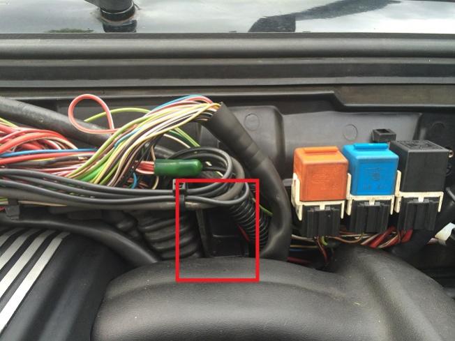

        Here's my predicament lol

          To make that look better just get the m3/318i covers for the firewall as stated above. That is easy enough. They can be a little tricky to get everything stuffed in there but it has been done time and time again.

            If you really want a nicer looking harness adapter, I can make you one for $180 shipped. I can also repin your harness and lengthen the diagnostic plug to fit in the original firewall cover location. That would also be $180 shipped, and you would need to ship it my way.

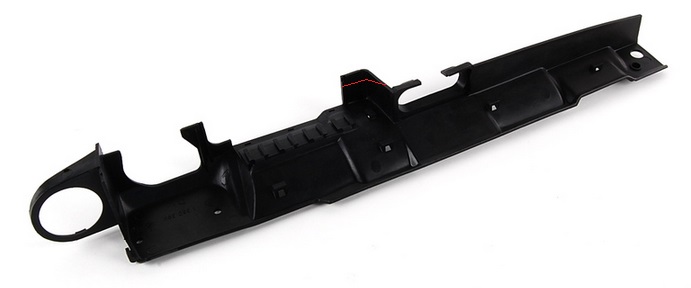

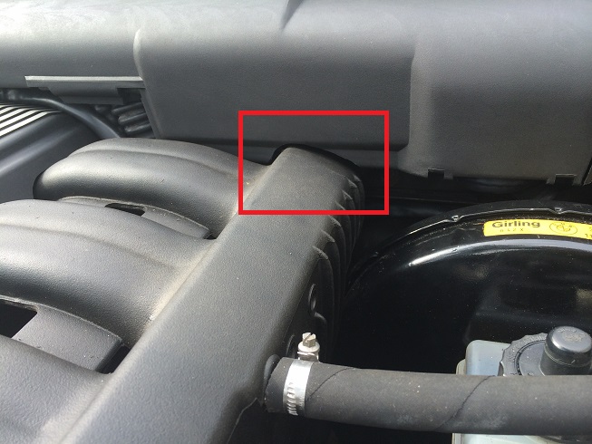

            But here are some pics of the firewall covers that will need to be modified.
            The parts that have a red box around them will need to be trimmed for clearance.
            Here are the cover part numbers. Look them up on ECS tuning.
            51711380390
            51711380391
            51711380392

              Can we get a clearer photo of the trim part of the bottom cover

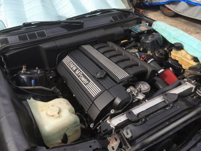

                I'm running one Nando made and it's been absolutely perfect. The engine covers make a big difference in how it all looks. Took a bit of trimming but it all fits.

                  That looks awesome. And everything just pnp? I really wanna clean up my bay lol

                      Yes sir. nando's harness adapter plugs into the factory body harness and plugs into the m50 engine harness. The covers are factory 318is and the passenger side cover is factory e30 m3 and was like $26. Well worth it.

                        I dont actually have a pic of it. But I've linked a modified image (Trim something similar to the red line). It basically just needs to be cut enough to get passed the intake manifold.
