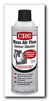

      Do you run a foam or K&N type air filter, and did you recently reoil it? The oil from these filters can foul the HFM, causing it to report bogus amounts of air. You can clean the HFM with CRC Mass Air Flow Sensor Cleaner. Clean it anyway, might as well remove that from the possible list of suspects.

          Forgot to mention I did clean the HFM with that exact same product. I should test the HFM resistance regardless to check it off the list of possibilities
