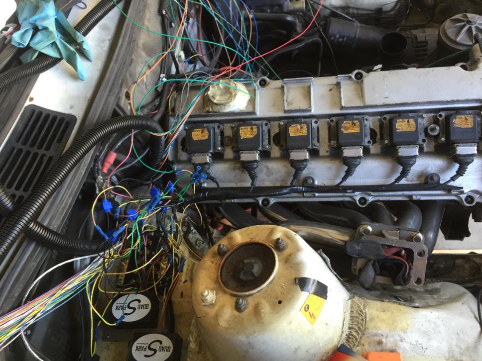

    Update!!
    Sorry for the delay!
    Work has been taking most of my time lately so I haven't had a chance to work on Betsy aka my e30.
    Have about 90% of the megasquirt wiring done, it syncs to Tuner Studio via my laptop and registers gauges. Just need to throw on the intake manifold after some wiring tidy up and fab the intercooler pieces together.
    Had the toughest time finding a way to route the relays together!
    Heres a few photos just as a teaser (Dont mind the mess)
    Coil packs all wired!
    Only issue I'm running into is how to route these fuel lines, do I need to keep the EVAP canister? And does one end route to the non pressurized fuel line coming from the fuel tank and the other goes where?
