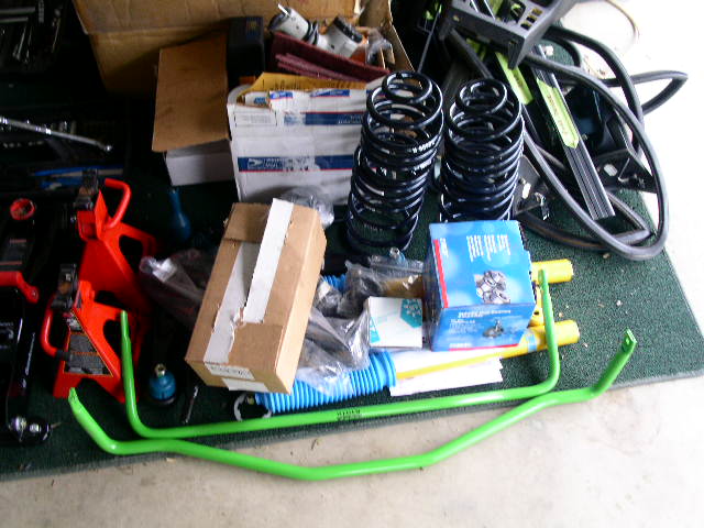

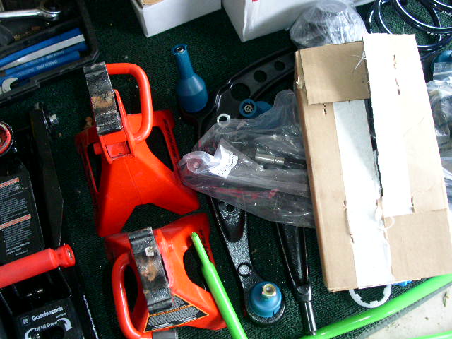

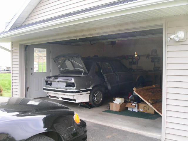

              I am about halfway through the swap.. got the engine in and got it driving, but i can't tell for any certainty.... i need to completely swap out the suspension with new springs/shocks as my front shocks are completely gone and the car bounces like pancake tits.. so until i get that swapped out and changed, i can make an accurate assessment... I'm sure ill notice a little bit difference, but it's been like 2 years since i've really driven an e30.... so hopefully i forgot what it handles like stock .. hahaha
              And yeah, you're right, it is heavier than even the M50/S50... it will be interesting.. It probably will be different and i'll probably just get used to it and learn it's limits after a while.. no big deal..

                I just upgraded to new shocks (Bilstein) and springs. I got the Eibach kit that is supposed to be right for the heaviest version of the E30.
                Based on my experiance, If you buy new springs, I wouldn't recommand buying a matched set, rather "mix and match" stiffer/longer front springs and lower/shorter rear springs to counter the effects of the heavier front end.
                  Well, i see what you're saying, but i think that sticking with the same springs all around... in addition to the added 80lbs in the front will give the car a nice front-rake look, which is what i'm looking for... as for the handling.. i dont know. i'm going to have to cross that bridge when i come to it..

                      Well, when i'm done in a few weeks, i'll start a thread to talk about it.. can't wait... should be a fun project..
