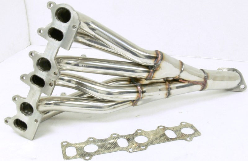

                              Make them 6-2-1 Maserati does that on their v12's for a reason..
                              this is VW's I always wondered what it would yield on a str6 BMW
