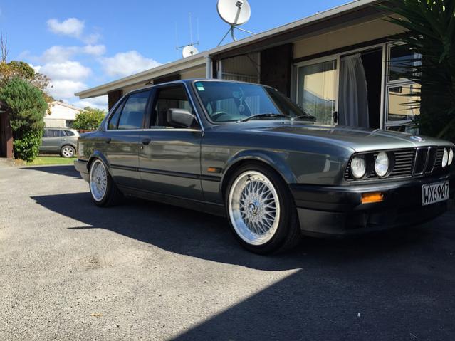

    Hey guys i have recently bought myself a 132,000km m50b25 vanos engine for my e30.
    My question is what should i think of doing while its out on a pallet? like what parts of the engine should i work on/ replace.
    New to this engine swap thing :)
