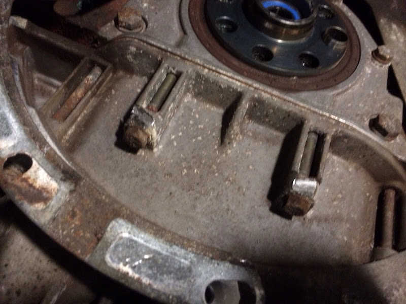

    so, by now you've hear a lot of things about putting either of the two styles of M20 single mass flywheels on a 24-valve engine.
    the thing is, if you just bolt it in you'll end up with something like this:
    and that won't work at all.
    so, your options are;
    1.) machine down flywheel
    2.) get two shorter pan bolts and shave down the mount steps
    I chose #2 because it takes 5 minutes and was free.
    perfect clearance. sawzall and a 4.5" cutoff wheel. did this with the engine in the car, no problem.
    hope this helps.

                starter got about half a turn then locked solid. knew something was wrong!
                for the record you can also run any old release bearing with a G250/ZF with this setup as well. the Euro 323 bearing is taller so you get bite closer to you on the pedal, but the 260 and 250 bearings will work fine.
