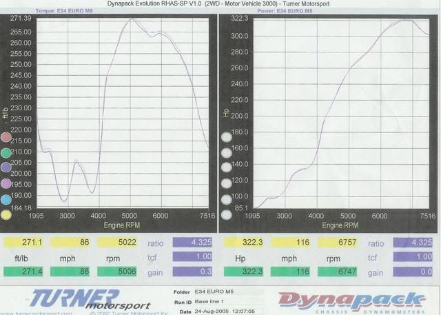

        Here's the dyno sheet on my brother's M5 after it had Scrick cams, custom software, and full exhaust (sorry for the huge pic):

          Wow, the transition from 4-5k has got to feel impressive, especially if it was in a lightweight chassis
