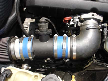

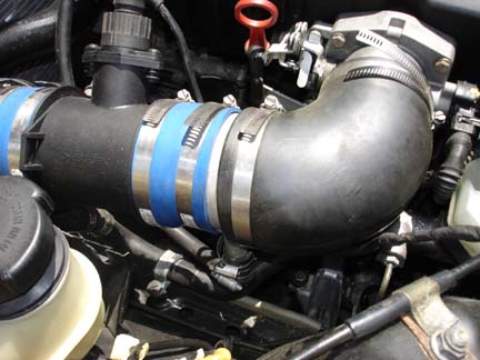

                  greetings from wisconsin. are you headed to gingerman with dave on monday? if so, stop by and say hi. now thats (5) e30s50/52's in wisconsin. if the pedal is that stiff, check your vacuume. might also explain the hesitation and uneven idle. if you had the same problem with the m20, check your fuel pressure. the secondary pump may be the only one working. i have run one car with no fan, one with the clutch fan (its a very tight fit) and my other one with a 16" electric pusher fan mounted in front of the condenser. ebay, new, 2600+/-cfm, under $40 to the door.
                  re: cold air intake.....i am currently making some air boxes to fit the smooth bore elbows i had made. if your interested, let me know. ive only got a few left. it consists of a 3.5 to 3.0 elbow, 3.5 alum spacer, 3.5 alum spacer with breather ports welded. see pics below.
                  also notice the cruse cable was secured with collars (with set allen screws) over vacuume hose.
