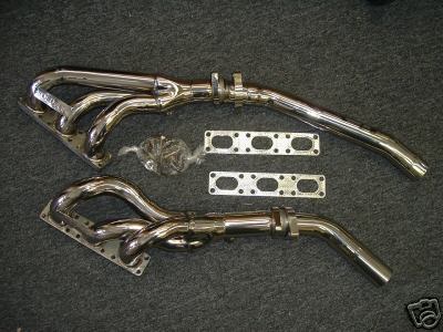

    Thinking about installing those on my car to substitute the heavy cast iron manifolds.
    Anyone installed those on their swapped e30s? Folks on bf.c seem to like them esspecially for the price.
    I don't have the treehouse lolipops, just regular e30m3 solid rubber CABs - would those headers clear the CABs?

      i have them installed on my m50 swapped e30. they fit very nice look a hell of alot better, are lighter, and sound better then my stock manifolds. i had to unbolt my regular cab bracket to get the hardware in but there are no clearance issues when everything is mounted. believe it or now i actually feel a power difference on my non vanos motor too.
        Interesting, fittament was no issue with the stock cab. I may have to pick up a set at some point.
          I've read on few comments on different forums a while back about those headers, they're just normal 328/S52 headers and polished. Can someone confirm this?

            Those are another set of 'ebay' headers

              I know for sure they fit with s50/2 powered e30s, so I imagine they work for any 24v.

                      Are these ebay headers OBD-II polished or the ebay shorty headers being discussed? Thanks.

                        Those are nothing like OBD-II headers.
