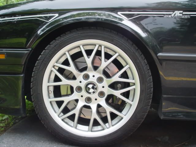

                          Looks good.
                            wow tiny caliper...
                            these are mine
                            all fixed sorry...

                              Originally posted by BeirBrennerE30
                              wow tiny caliper...
                              these are mine
                              Sweet red X.....
