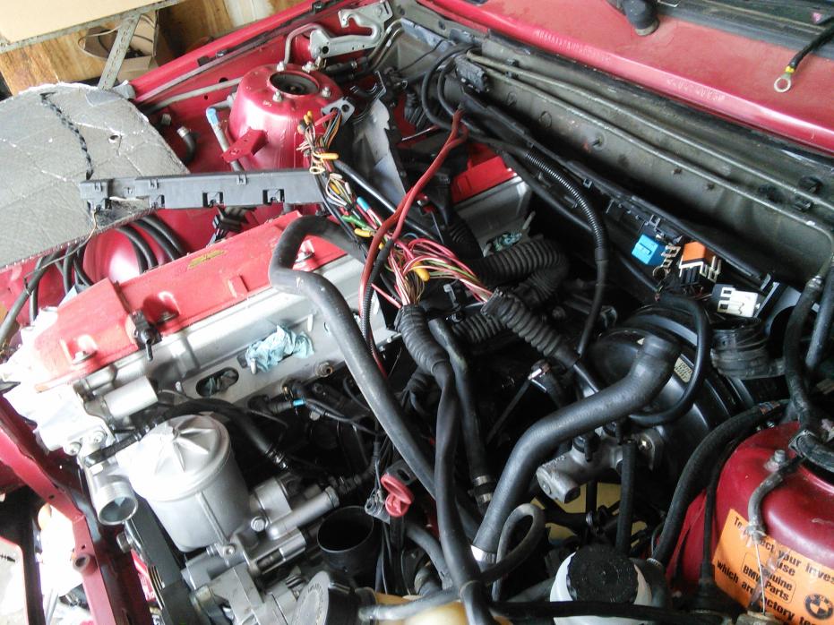

    I have a coupe and I'm trying to install the back part on the cable mgmt to the vent access lid but the existing studs do not align and or the holes on the back of the cover
    So let me know how you adjusted to fit
  • M3PO
    • May 2012
    • 537
    On my '84, I had to drill a few new holes in the plastic housing to match the studs on the HVAC fan cover.
