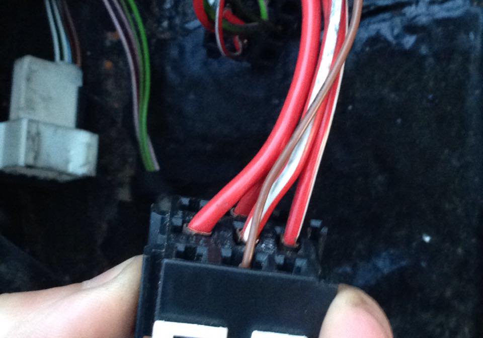

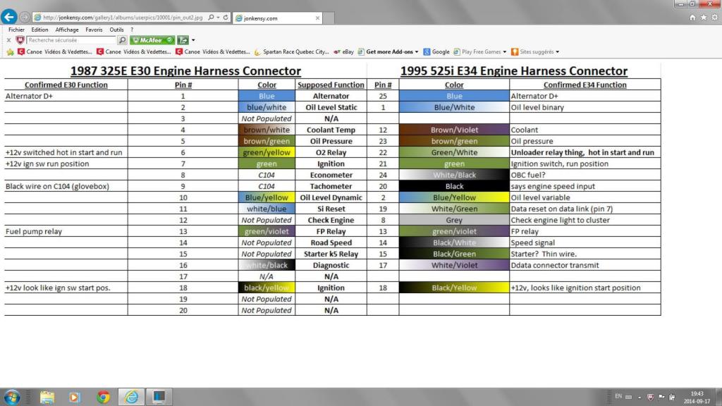

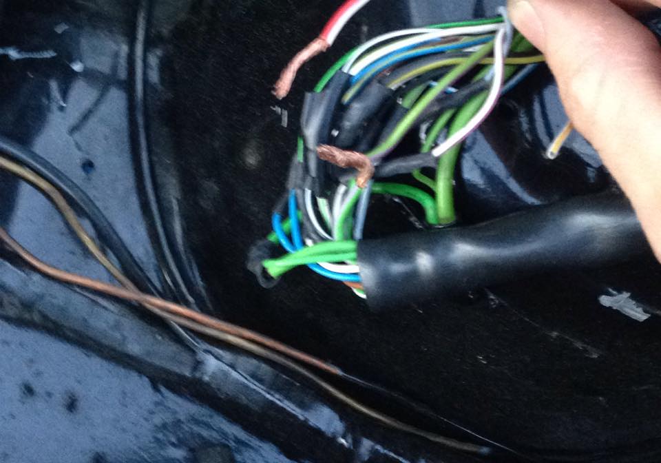

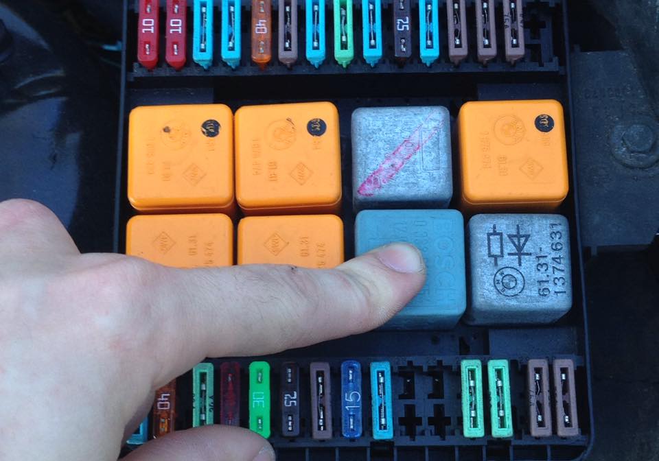

    hi,everytime i plug a new relay in the dme relay is snoozing and break i try 2 different relay today and work in the begginning with the snooze and break off.where the loom of the e34 i have a red white wire.the wire match with the red wire on the dme relay. if i don'T connect it with the fuel pump wire(green/violet) every lights in the cluster still on when i remove the keys and the fuel pump doesn'T work when the keys is on. i did my wiring with this diagram i check with the repair manuel but i can'T find what the red/white wire is.also i have a click from the bosh relay from the fuse box. i don't know what to do anymore did i have to add some modification on the c104 or we don'T touch it ??? cause this red/white wire is for the dme relay for sur
