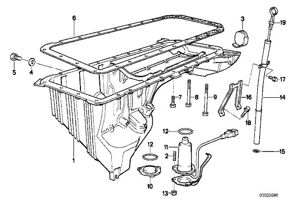

    I am not sure if anyone has ever managed to hook up the e34 oil level sensor, but I am not bothering with it (I bought a new oil pan, no sensor) so I found a block off plate from some sort of euro car with no oil level sensor.
    BMW #s
    11 13 1 726 357 - plate
    12 61 1 277 129 - o-ring
    This will increase oil capacity somewhat, and gets rid of some useless hardware, which I like.
    So now my question is... what is the oil capacity of the e34 oil pan? Thanks!

    BMWE34.NET says:
    525i M50 / 535i: 5.75 liters (6.1 US qt.)

      I bypassed my oil level sensor since I thought it was leaking.
      Machined a piece out aluminum.
      -Car holds about 6.5+/- US quarts.
      oil leak turned out to be o-ring on dipstick tube.

        • FredK
          • 14761
          On the E34 oil pan, there's a sensor that attaches to the bottom of the oil reservoir. It's part 11 in the attached diagram. As you can see, it's a cylindrical part that displaces some oil volume.

            Right.
            11 13 1 726 357 is part #10 in that diagram, in case you want to do away with the sender.

              Yup I used #10 also, except I cant make the little fuck stop dripping oil..

                You have an o-ring that isn't nicked or torn? You have it torqued properly?
