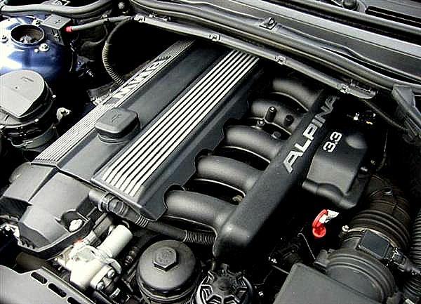

    I really find that bottle to be annoying in its stock location. I notice that on the e46 they moved to the front and even the E36 Alpina moved up to the front
    E36 Alpina

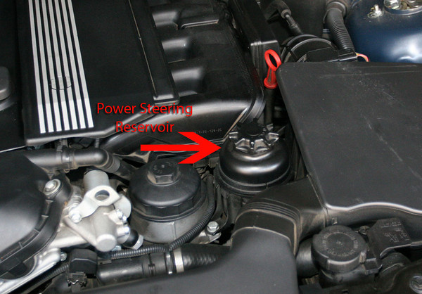

    Even the E9x have them away. I personally would like it over by the washer fluid reservoir is on the passenger side if possible..
    E46

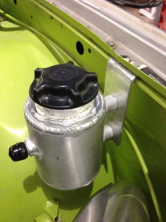

        No I actually want it as the obove picture or far away over by the fender like they did here below..
