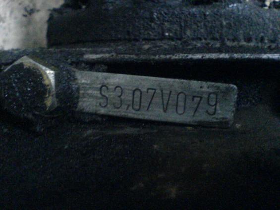

    There is a little metal tag attached to one of the rear cover bolts that indicates that ratio of the diff, check there and report back the ratio. If there is an 'S' along with the ratio number - it is limited slip.
    You can also tell if it's limited slip by the turning one of the output flanges. If you turn one and they both turn in the same direction - it's limited slip, if they turn in opposite directions - it's open.

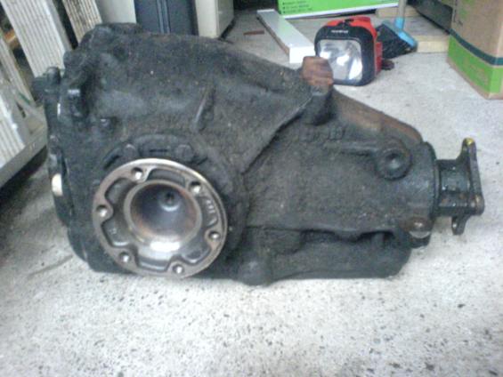

                Can you post a picture?
                • NZM50SWAP
                  • Feb 2006
                  • 75
                  Yeah sure :p
                  • Mike B.
                    • Jan 2006
                    • 987
                    You need to replace that rear cover plate with the one from an E30. Once that is done you should have no issues with mounting it up. It looks just like the one I put on my car (3.46S).

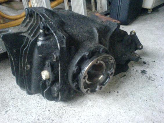

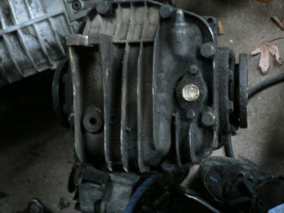

                            Are you shore Jason?
                            Casue I've being told that I can't swap the output flange's and axels out of my e30 320i diff onto the larger LSD that I have. Plus it's a 3.07 ratio so I was kinda hopeing I could swap the centre but that's probably out of the question to. Here's some more pic's.
                            • Mike B.
                              • Jan 2006
                              • 987
                              Based on the info that you have given us, if you want use the diff, you will need output flanges from an E30, new axles from an E30, rear cover plate from an E30 and properly modify the body of the car (320i) so you can bolt it in place.
