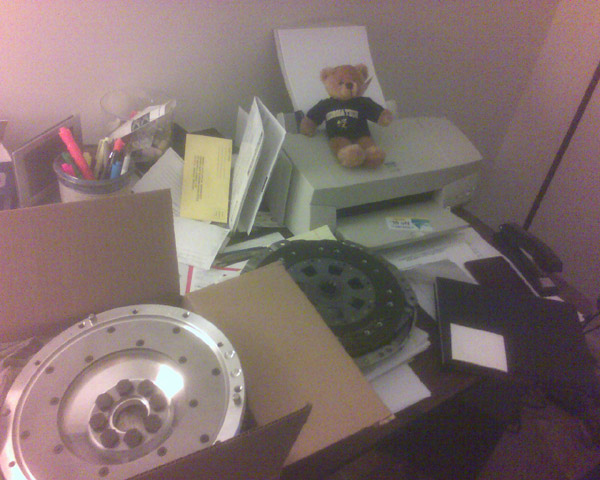

                          Flywheel showed up today!
                          • FredK
                            • 14763
                            Nice teddy bear.
