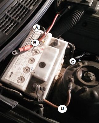

    Battery pic:
    - A: from M50 harness (black)
    - B: from M50 harness (red)
    - C: M50 harness ground (strut)
    - D: M10 ground ?

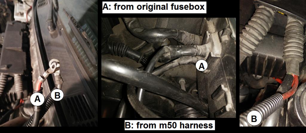

    Other pic:
    - A: from original m10 fusebox
    Do you guys know where each cable connects to ?

    I can't see what is going on in the battery pic. The wires in the other pic look like they're the ones for the starter, no? I can check on my M50b25 tomorrow.

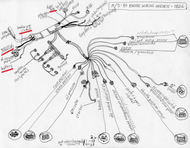

      Thanks for your answer. Here is a better picture of which cables of my M50 harness still need to be connected (underlined in red).

        If you use the E30 fuse box cable (I did), you don't need the cable from the M50 harness. The rest are just power (12V) and ground (earth/strut tower).

          I've plugged the e30 fusebox + battery + battery red to the +, the ground to the strut and the red wire from the strut to the -. It seems to be wrong because every electronic component can work (wipers) even if I don't turn the key in the neiman. Where did I go wrong ? Is it because of the ground on the motor mount ? Is it supposed to be plugged on the silentbloc screw ? Sorry for newbie questions but I'm a dick when it comes to electric.
