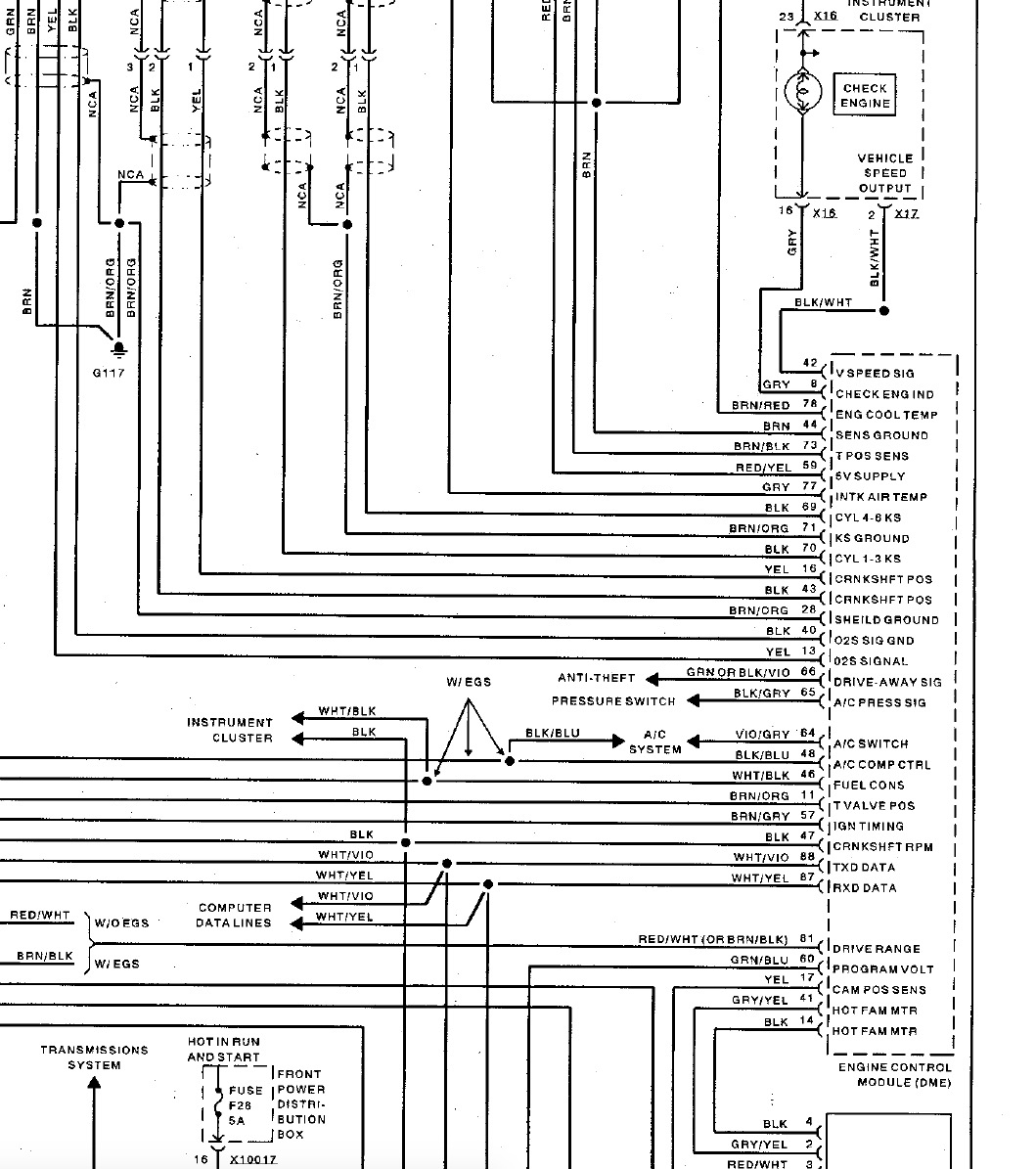

              Slight update on the secondary issue– the 24v AC Idle Bump:
              Per this thread, "MC Hammered" (thank you!) posted what sounds like a decent fix. Note that pertains to a "MS41.1" OBD2 DME.
              For us OBD1 (413 & 503 DMEs) swaps the pinout will be slightly different, but the relay concept should still work.
              IF I understand this correctly, essentially: Running ground to Pin 16 (obd2 cars) triggers idle bump. But we don't want this on 'all the time', only when AC is activated. The relay grounds that pin, while supplying +12v power to pin 19 (obd2 cars) to kick on the compressor.
              As I'm looking at the OBD1 (2.5L for my harness/dme) engine management wiring digram I see this for the pin out:
              - AC Switch : Pin 64 Violet/Gray
              - AC Comp CTRL : Pin 48 Black / Blue
              - AC Pressure Signal : Pin 65 Black/Gray
              So am I right to say that for OBD1 cars this relay is to ground Pin 65 and +12v to Pin 64?
                      Anyone have some insight on OBD1 swap idle bump. I've searched to my hearts end and don't have a very definitive solution to this and I'm not quite comfortable enough with the above^ to go 'fishing'.
