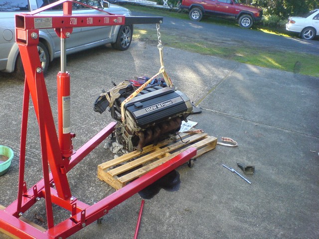

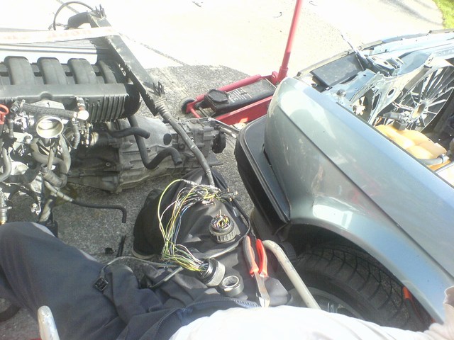

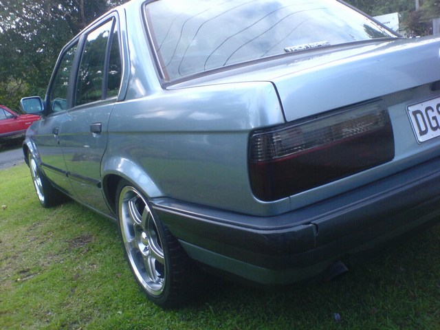

    Finally I've got my picture's on my computer of my swap.
    Motors in and I'm just hooking everthing up. Engineer is making up some extractor's and a gearbox corssmember at the moment so hopefully will be driving it next week.
    Thanks to everybody on r3v limited as this forum as being the main resource for information. Special thanks to addiss for his help and that wiring chart he made up. (saved me buying treehouse adaptor $749 NZD)
    Here's what I out with. 89 sa 320i 5spd with broken cambelt
    92 nonvanos 2.5ltr m50 out of e34 auto

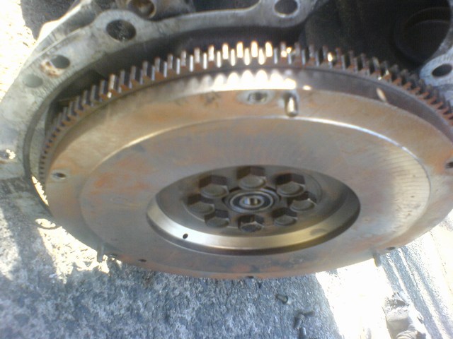

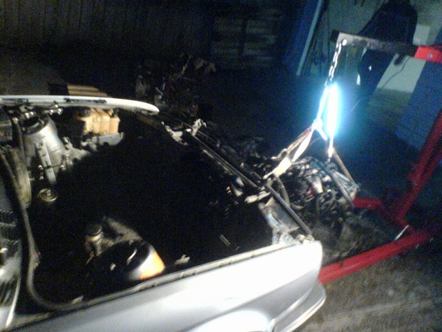

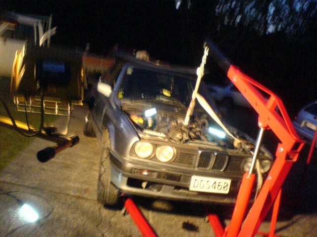

      Continued

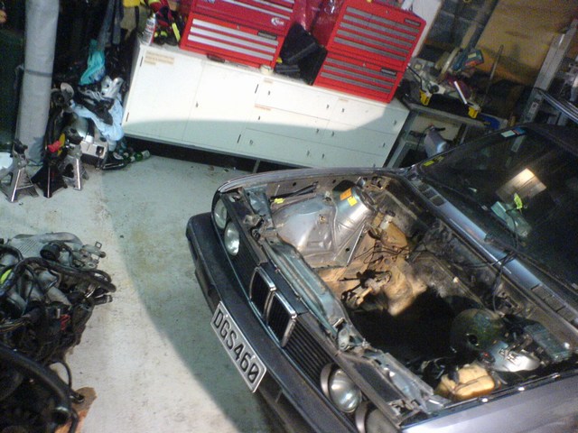

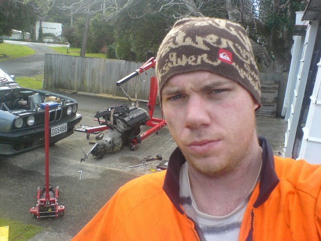

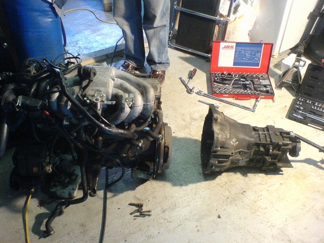

      Running into the night we managed to get the m20 out with minimal fuss and damage.
      The next morning I had a close inspection of the engine bay only to find chassis rust. FUCK! So had to do a bit of welding and pooing to fix that up.
      After m20 was out I began to remove the e30 brake booster and swap it for the allready prepared e21 booster with e30 rod attached. Then began pulling the trans off the m20.

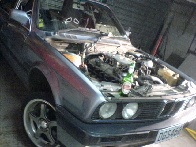

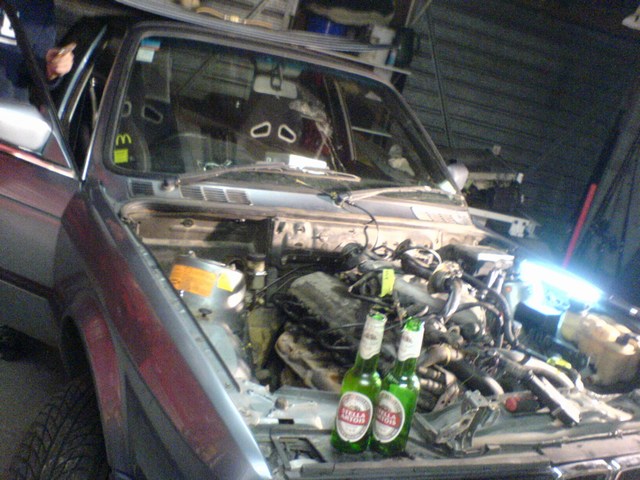

          Stella. Mmmm, tasty skunk!
          • NZM50SWAP
            • Feb 2006
            • 75
            Yeah bro and they Kick some ass.
            Hahaha went fishing yesterday and drank box of 18.:drink: Went to hook the boat back up to mooring and fell str8t in the water. Gezus!!:crazy:

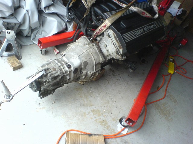

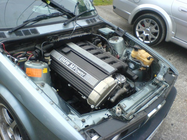

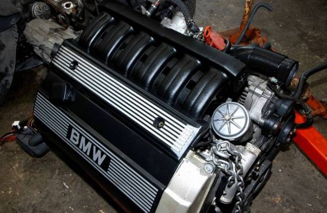

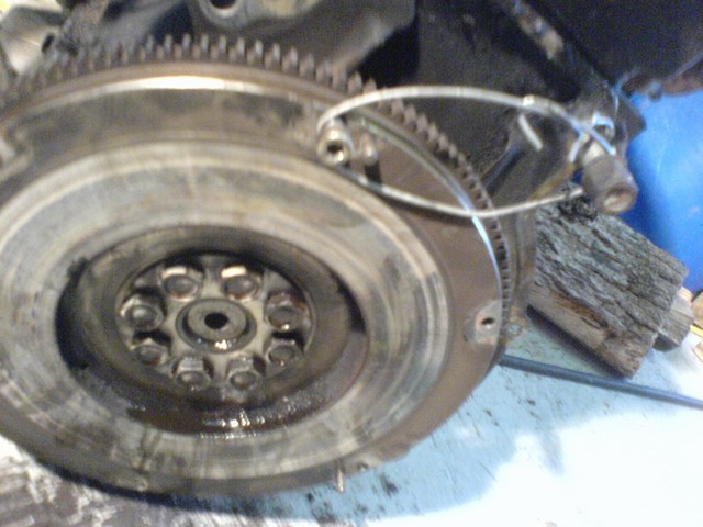

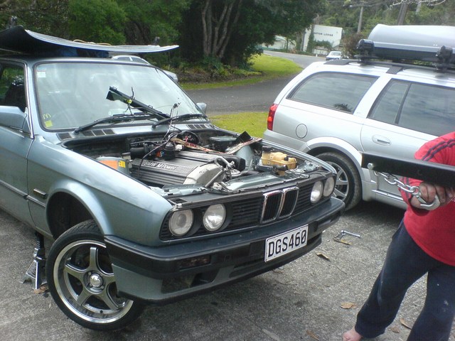

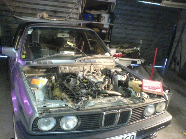

              On with the show....
              Once again big thanks to addiss
              With out your help that m50 would still just be sitting in my driveway

                Note in the last picture my mate without shoe's.
                Lol us Kiwi's live in bare feet. Not the safest but who give's a fuck

                  Thought I'd add a mugshot of myself so uz can see how fucking stunning I look..... :pimp:

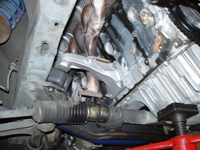

                      Have you modded the manifolds (headers) yet?
                      I did mine myself if you need any tips, im also RHD and ive got an E36 rack in there too
                      • NZM50SWAP
                        • Feb 2006
                        • 75
                        Not yet aye dan
                        I'm getting some made up from scratch using the cast manifolds as a template Got any pic's of your setup?? I'm running a non power steer facelift rack in mine
                        • DanThe
                          • Mar 2006
                          • 98
                          Combination of E36 328 tubular manifolds and E30 323 frontpipe
                          You should get an E36 rack ;)
                          Deffinatley worth the extra effort
