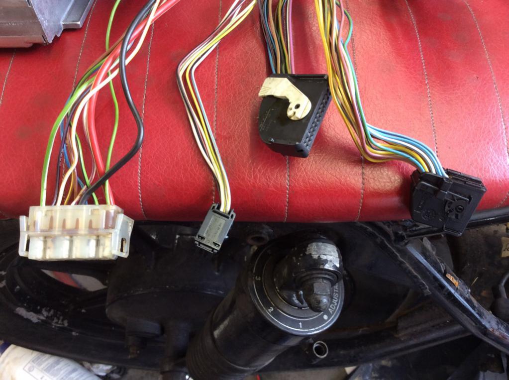

Hi guys,
I have an engine from 728i e38 and harness doesn't have the x20 i am confused do i :
1- need to change the harness?
2- or just connect the wires by colors to c101 if the wire color codes in e38 harness are the same color codes as in the e36 harness using the e36 wiring codes?
3- are there any differences in these e38 m52 engines from the e36/e34 that i need to take care during my swap?
4- do i need to reinforce the subframe since it's 2.8 (heavy iron block)?
Good thing: e38 oil pan is the same as the e34 (front)
