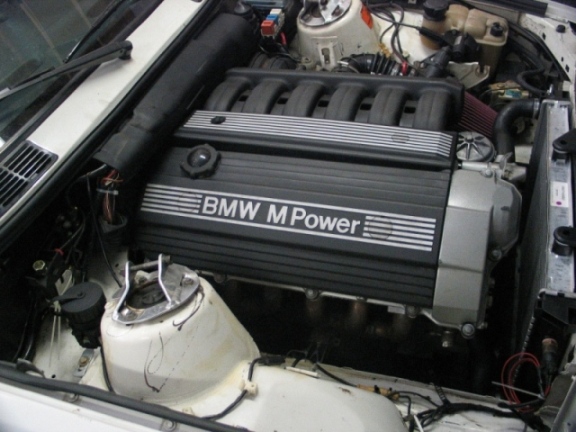

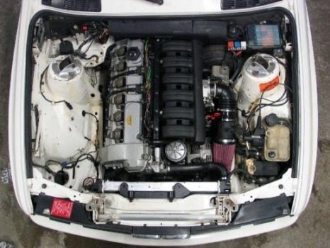

    Woot woot, another fast one!
    I still need to add a muffler, but I think I've got this thing sorted out for the most part. And, it's quick! Still have the stock 4.10lsd in which will eventually have to go, but it's going to be fun for a little while. I'm getting some serious squat with the 1st to 2nd shift. It just rips through 1st, 2nd, 3rd, etc... I'm trying to be easy on it since it's a freash rebuild, but it's hard. I'm pretty sure if I even try to go full throttle in 1st without pointing straight this thing it going to loop around. What a hoot!
    Here's a few details:
    1988 e30 m3
    rebuilt s50 - new rings, bearings, valve grind, etc...
    95 e36 m3 transmission
    e30 m3 stock driveshaft
    e30 325i single mass flywheel - shaved & lightened to clear the motor
    e30 325i pressure plate and clutch
    e30 325i starter
    e30 325ix break booster mounted directly to firewall
    e28 m5 master cylinder (had to reflare one breakline)
    e36 325i radiator - sits low in the e30 m3, crafted some upper mounts to fill in the gap - trimmed down e36 radiator hoses to make a better fit
    s52 headers to an s50 cat section
    rear muffler is going to be my old e30 m3 Borla (temporarily)

        Where'd you get the S50 rings? It seems like the stealer wants $600 for a set! Did you get some aftermarket rings somewhere? I've seen them for around $180 a set for the off-brand rings...
            They are hard to find aren't they!? I got them direct from Deves. I think they recently added them since I called them a long time ago and they didn't have them. I don't recall the part number, but they referenced 95 m3. The specs matched the s50 and they fit. Cost was around $260. I opted to spend some more for a reputable brand over the $180 ring set.

              Looks good, whats the reason you went with the e30 clutch stuff?

                    That's what im talking about ! You gotta get rid of that 4.10 though . When i had that setup 1st and 2nd were useless and 3rd pulled like 2nd in my old modded M3
                        I just couldn't put that hunk of e36 flywheel back in and lightened flywheels are way too spendy. Next best option was to use a 325i flywheel.
                        I know! Where can I find a 3.25 lsd? They’re hard to find.
