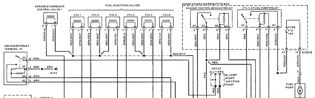

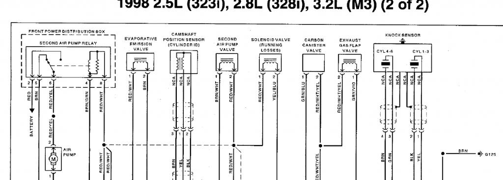

My megasquirt unit just came in so I decided to take another look at my harness and double check all of my traced wires label everything before i start the install process. Something I hadn't really thought about until jus now was the relays on the engine harness. They appear to be either unnecessary (in the case of the secondary air pump relay) and potentially duplicates such as unloader relay, fuel pump relay, and main relay.
Someone please correct me if I am wrong, but the unloader relay, fuel pump relay, and main relay are all in the engine bay fuse box. Can I remove these without worry from the main engine harness as they appear to be duplicates? I can't think of any reason why not, but I wanted to make sure.
