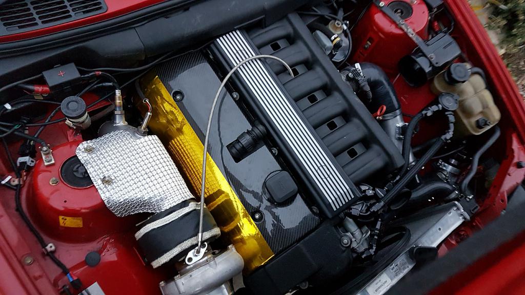

      euro diesel fan: 11522243303
      not using with M42 radiator though, stock e36 radiator.

        That euro fan is pretty slick. If it cools that turbo monster....
        Nice looking engine bay!

          80c thermostat, this fan and e36 radiator, coolant temp sits around 83c through most conditions, even on 35c or higher days
