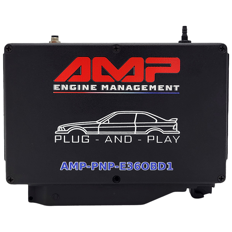

        For example these or same specs from other manufacturer:
        The stock bosch ecu can be tuned, but results I have seen have been really poor. One turbo setup was totally undriveable after some expert tuned it. That was later converted to ms41 from m52 and now runs like a champ using the m52 stock ecu tuned for turbo.
        From budged aftermarket ecu's the megasquirt ms2 or ms3 are really good. There is now even PnP ms3pro available to your engine.
        Replace your 413 or 506 DME! The MSPNP Pro Standalone BMW E36 ECU allows tuning your BMW E36 or E34 with a laptop to maximum performance!
