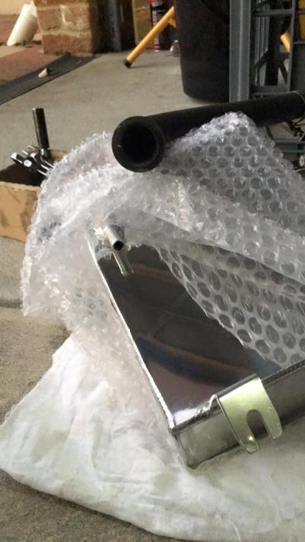

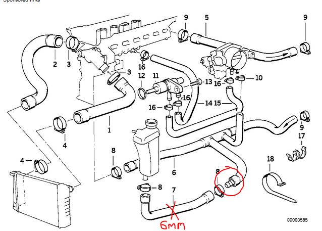

Hi guys,
Bought an aftermarket overflow tank for the m50, which has a 6mm ID nipple to feed the cooling system if it's short
Though the overflow hose from the spider hose is around 22-24mm,
Can I just run a reducer, or should I weld in a larger nipple on the overflow tank?
Is it a pressured system? I'm just trying to think if the spider hose sucks the coolant from the bottle it should be okay to do the simple thing and reduce the hose,
