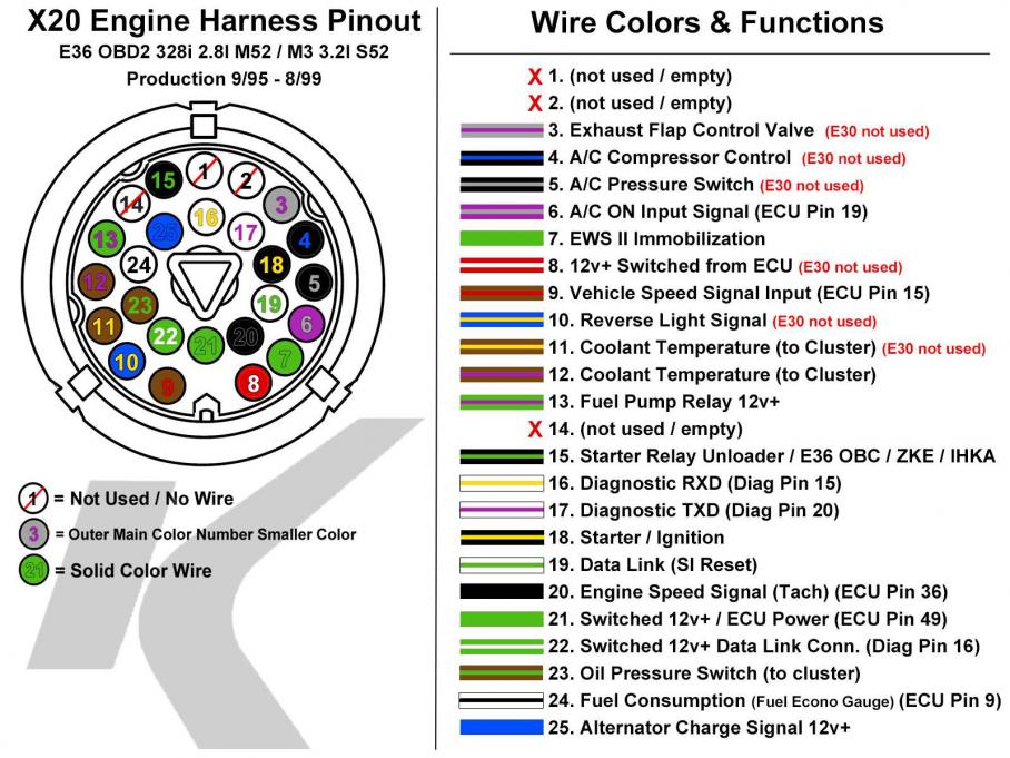

    What is this sensor for? I have found every other sensor in the etms except this one, Neither pin is connected to the dme. 97 328is harness.
    blue/green
    green/white
    My bet is exhaust flap?

    reverse
    cars beep boop
    • ZekeTheSneak
      • 1562
      The reverse switch on the tranny?
      • kronus
        • Apr 2008
        • 13032
        yeah
        also that's definitely yellow, not green.
        cars beep boop
        • ZekeTheSneak
          • 1562
          Thanks kronus, yah its hard to make out the color. Where did you get that pinout chart?
