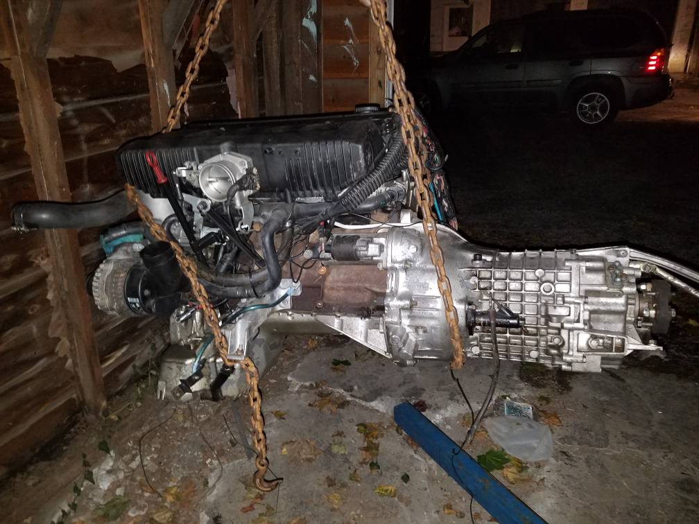

    I have m50nv g260 and 4.10 diff , will a 325 driveshaft work ? I'm not sure what car mine came out of

        What year/model is your car itself? And is the transmission original to the car or do you know the vehicle it came out of if not? (Sometimes the VIN stickers will still be on the bellhousings which can be punched into a VIN decoder)
          It's an 89 vert the tranny isn't original but it's still a g260Click image for larger version

            Stock replacement 89' 325i manual transmission driveshaft should be what you need then.
